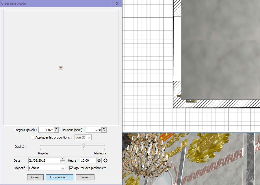

Since yesterday (I wrote too fast), I have found that the generation of pictures with the standard tool on Mars project (181 Mo) had a problem. sad
Aerial view and virtual tour are very slow...
2 different results:
1. the standard tool stops
2. the standard tool disappears.
I'd first thought of a large project, so I choose another (Versailles - 136 Mo) and there, same problem...
Same thing with rendering 1.3.1 sad
Do you have same problem ?
NB : task manager said :
processor : 99.2%
used memory : 6 721 Mo
The third test was OK with Gallery of mirrors (Versailles) in 800x600 in Q3 and OK with R1.3.1 !?!
OK with an another project (60 Mo) and with fortified castle (102 Mo) confused

Indeed simplified the project after everything is back in order.
A board would not load your projects too otherwise you risk crashes. crying
One of mine weighed 302 MB, he returned to 105 and it's OK... smile
I think I have reached the possibilities of the software. crying
