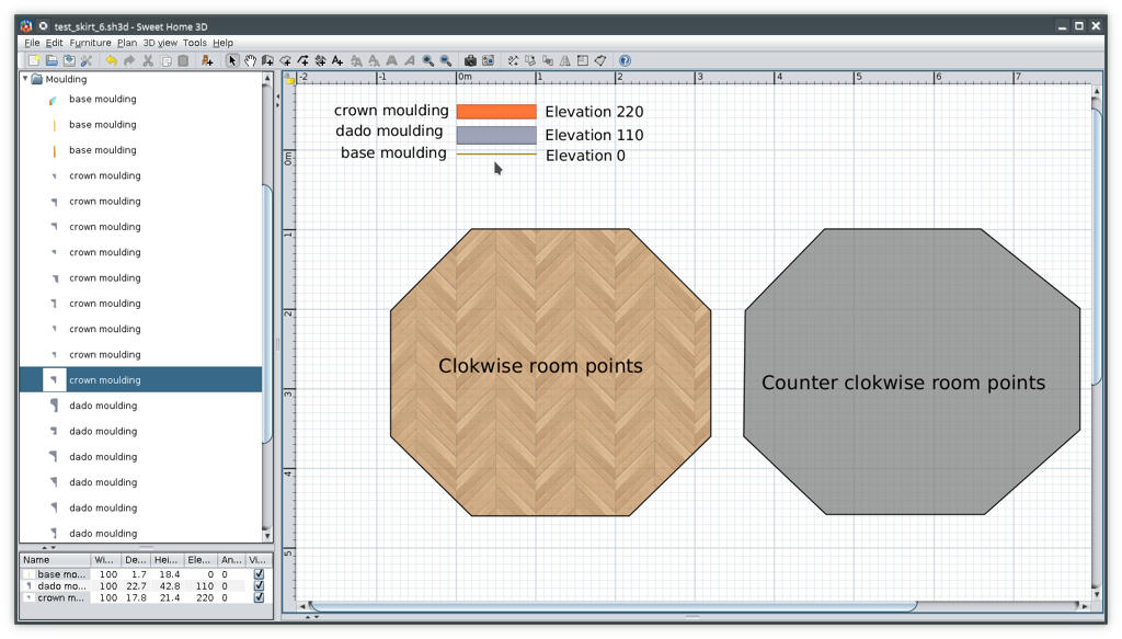

-Create room(s);

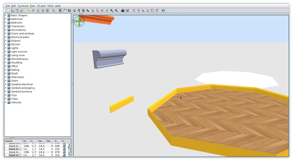

-Insert mouldings somewhere in the plan;
-Set the elevation for them.

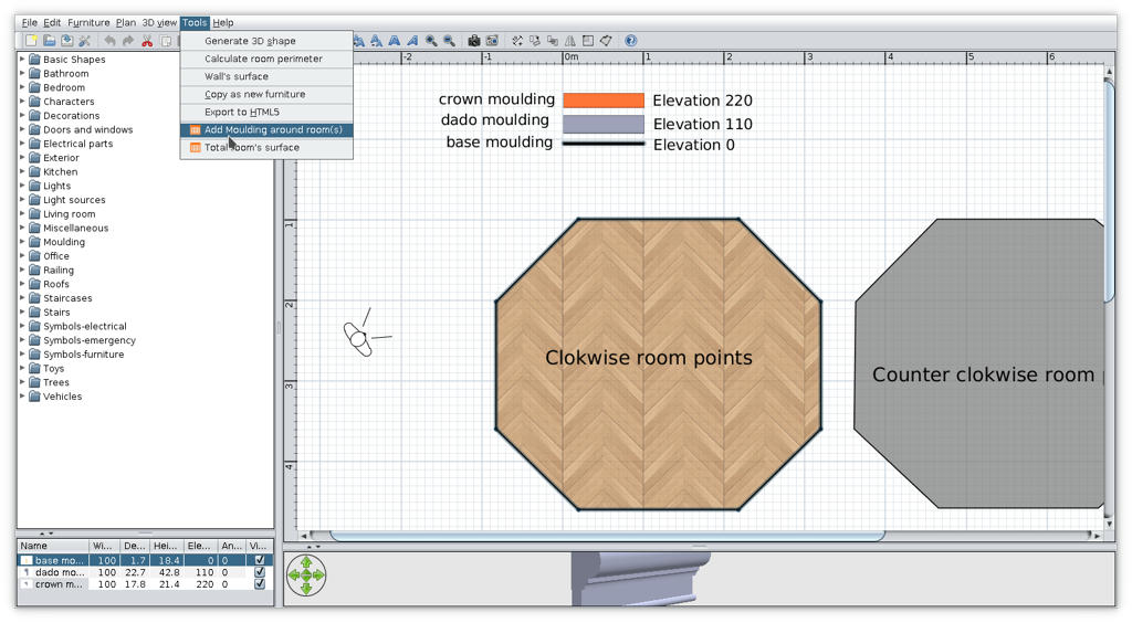

-Select room AND the moulding (in that case the base);
-Tools->Add moulding around room(s)

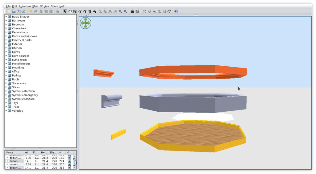

-Repeat the procedure for other piece (dado and crown);

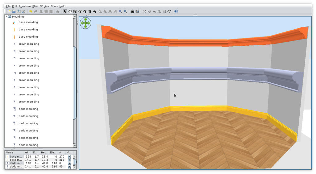

-This could be the result
-I inserted walls around room and delete some of them and some moulding to have a good view
I know is not what You expect but that's for now.
