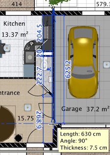

- Some temporary dimension lines are now displayed along walls when you resize them.
- Some temporary dimension lines are also displayed while drawing or modifying a room, showing the length of the two sides starting from the edited point plus the diagonal to the previous point. This should allow to more easily draw rooms using triangulation.

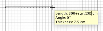

- It's now possible to enter math expressions in editable plan tooltips.

It was nice if one can enter exact dimensions/expression while editing wall or room. Now it's possible to enter only when room or wall is creating.

Temporary dimension lines
This is useful, You might consider making their appearance depending on the amount of zoom to avoid crowding the screen.
That's what I had in mind. I could also not display them if the number of the dimension line becomes invisible at screen because of the zoom factor.
