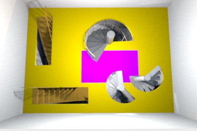

I have a question about putting stairs in: When you put them in, shouldn't they punch a "hole" in the floor above, or below them like windows and doors do?
I just added this feature in version 3.4 Beta 32.
This required a new property in the description file of the furniture of the catalog. I called it staircaseCutOutShape and it describes the shape used to cut out the ceiling and the floor of the upper levels when they intersect a staircase. This shape should be written with the syntax of the SVG path element described at http://www.w3.org/TR/SVG/paths.html (for example, M0,0 v1 h1 v-1 z describes a 1 unit wide square). This will allow to have complicated shapes like a pie shape for spiral staircases, as show in the following image and the attached document:
To let you import 3D models as staircases too, I added a new Staircase checkbox at the third step of the import furniture wizard and in the upcoming update of the Furniture Library Editor. In that case, the cut out shape of the staircase will be a rectangle with the same width and depth as the object itself.
