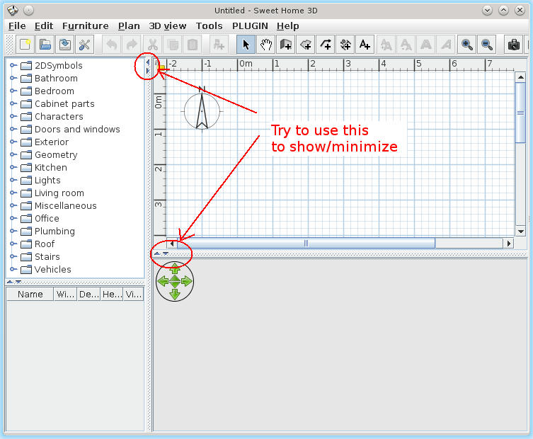

I like the fact that the 3D view can be moved to a separate window, however there is no way to minimize it. Given that it is often desirable to work with the plan view in fullscreen, it would be great to be able to hide the 3D view entirely with a toggle of some kind.
I've currently been launching Sweethome3d with the 3D view disabled, but I have to save and relaunch in order to bring it back, which is less than ideal.

I don't have those handles in my version (running on Linux using IceTea Java), however I have been manually dragging the window areas to the bottom and side as a workaround. It's hardly as quick and easy as a toggle though.
