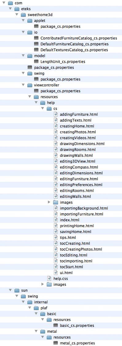

        Renaming files depending on your language
         Before translating the .properties files, you should
          rename each of them by adding to their name an underscore followed by
          the 2 characters ISO code matching your language. You'll find this code
          in the last column of the document https://www.loc.gov/standards/iso639-2/php/English_list.php.
          Then, if you want to translate the help files, you should rename also
          the en subdirectory of help with that 2 letters
          code too.
          For example, the ISO code for Czech is cs. If you want
          to translate Sweet Home 3D into Czech, each file name should be suffixed
          by _cs, and you should rename the files as shown in figure 2.
          Figure 2. Properties files with their ISO code suffix

          - Search the dates of Sweet Home 3D versions you want to compare in history
            (for example, July 19, 2015 for version 5.0 and February 2, 2015 for version 4.6)
          - Click on the
.properties or .html file
            you want to update in figure 1,
          - Select the two check boxes of the revision number matching the version date for the updated file,
            choosing the date that is just before a version date of Sweet Home 3D,
          - Click on Compare button.
        The last click will show you the differences between the two versions
          of that .properties file (for example, this link
          will show you the differences between the version 4.6 and the version
          5.0 of the file com/eteks/sweethome3d/viewcontroller/package.properties).
        Once you found the differences, udpate your translation, adding new
          key names if necessary, and release a new version of your translation.
